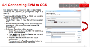

Hi Akash,
I used AWR1443BOOST ES3.0+DCA1000EVM to capture row data successfully a few days ago.But today I follow the steps in TI mmWave Labs Vital Signs Measurement,by step 4(Preparing the EVM) I flash C:\ti\mmwave_sdk_02_01_00_04\firmware\radarss\xwr12xx_xwr14xx_radarss_rprc.bin
C:\ti\mmwave_industrial_toolbox_4_7_0\labs\vital_signs\14xx_vital_signs\pjt\Prebuilt_binaries\xwr14xx_vitalSigns_lab_mss.bin(this one is false,should be C:\ti\mmwave_sdk_<ver>\packages\ti\utils\ccsdebug\xwr14xx_ccsdebug_mss.bin)
After step 5 (Runing the Lab),an error was reported when connecting XDS110 USB (the error content was not saved)
Then I stop and power off and reset,try to connect the AWR1443 board again,but the computer cannot drive UART and Data COM port.
The two ports of UART and DATA cannot be driven by reinstalling CCS.
Do I erase the USB drive in the board?Is there any way to redrive the two COM ports?
In addition, the power status of the board is shown in the following figure.
Only DS2 red and DS4 yellow are on, the other two lights are off.
Thanks Zhonghui
