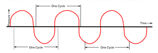

    Thank you for your question. Sorry it was not explained thoroughly in the documentation. But what is referred to as  "#cycles" in the document, is the number of cycles in the transmitted pulses. Essentially the number of cycles is how many periods are in the entire burst train. The figure below illustrates a cycle and how they can be measured in different places just like the period of a wave.
    The formula to calculate axial resolution is dependent on how many total cycles can be found in the ultrasonic burst that was transmitted. I hope this answers your question.

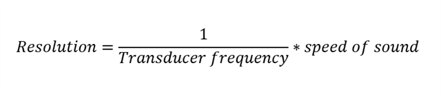

    Instead the resolution is dependent on the frequency of the transducer, because this will determine the size of the actual wavelength. A lower frequency transducer will have a larger wavelength and higher frequency one will have smaller wavelengths. Additionally the amount of cycles produced also depends on the transducer dampening being one of the main factors determining how many cycles get produced.
    I find this formula for resolution below, to be a little more helpful, since it does take into consideration the speed of sound of the medium. The end result is similar giving us the smallest measurement possible between two items in an ultrasonic system. The main difference being that these values for the transducer frequency and the speed of sound are much easier to find. A data sheet for a transducer will not give you the amount of cycles the transducer produces.
    Hope this helps!
