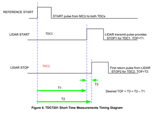

    We are doing an short time measurement with the GUI and our TOF is stop TDC2 - Stop TDC1 as shown in the picture:
    From your explanation it should be possible to read out the TDC2 stop time and TDC1 stop time and then do the calculation in Matlab correct? Can I read out this Data by the Uart debug interface from the MSP, since I need the other Interface to communicate between the MSP and the GUI? Do you now the registers were this two informations are transmitted by Uart. I'm new in reading out data by Uart, so I'm open for every help.

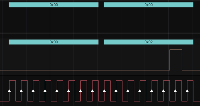

    This is an example of the SPI communication when reading a register TDCx_CONFIG1 register 0, with the device in mode two:
    This is an example of the SPI communication when reading a register TDCx_CONFIG2 register 1, with the device in two stops and 10 calibration clock periods:
    You can decipher what the registers are telling you by looking at the register maps. Keep in mind some registers on the device are 8 bit registers like the ones I showed here and there are some others that are 24 bits long. The register map can be found in section 7.6 of the datasheet.

    Thank you again for the further explanation. Now I understand the situation much better, but I have to explain it more in detail, that we are talking about the same situation. We are using the TDC7201EVM in combination with the MSP430F5529LP. So from my understanding, when we are doing the following measurement:
    The TDC1 will measure T1 and TDC2 will measure T2. Both informations will be sent to MSP430 and the MSP 430 will then calculate the TDC avg time  with the calculated T3 times as marked in my text befor. This time will then be transmitted from the MSP430 to the GUI. As I understand the situation. I would like to read out this value from the MSP430 by the interface UART to calculate in Matlab the distance. Uart stream can be activated in the GUI.
