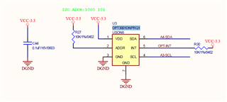

Hi Team,
There is a good news that we DIN OPT3001DNPRQ1
Please check the SCH ,THX

Great news. ADDR should to be shorted to VDD if addr 0x45 is desired. I2c lines will need pullups somewhere on the board. They should also check that the pullups chosen are correct based on the overall bus capacitance.
