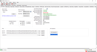

    It would be good if you could post a screenshot of the Connection Tab in mmWave Studio with the output log.

    Attaching the output of mmWave studio for reference:

  • Hello Jejomar,
    Thankyou for your inputs here.
    As you can see the MSS Firmware version is 0.0.0.0, it means the MSS Firmware wasn't downloaded properly.
    Did the customer try clearing the flash contents using Uniflash in SOP 5 mode and then resetting the device again in SOP 2 for connection.
    This usually happens when there is some junk in the flash and we have mostly seen this issue go away after formatting the flash.
    Please try and let us know your insights.
    Ishita

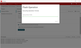

  • Hello Ishita,
    Thank you for your response. I've shared these procedures with our customer and received their feedback as follows:
    I downloaded Uniflash and tried to format the flash. I have tried in both SOP2 mode and SOP5 mode (SOP0=1, SOP1=0, SOP2=1, that's correct?). But I am unable to proceed with the loading of the formatting, although I am able to start it. I am attaching an image of the problem.
    Kind Regards,
    Jejomar
  • Hello Jejomar,
    Yes, it looks like they're not able to format the flash.
    Here are a few pointers to check in uniflash:
    • Please make sure that you have set the right SOP jumper (SOP0 and SOP2) on EVM in order to put device in flashing mode. Do the power cycle after putting the jumpers then start using Uniflash.
    • Make sure the COM port number is correct in the Uniflash ‘Settings & utilities’ TAB. This COM port should be the number which is populated as a “XDS110 Class Application/User UART”.
    • Disconnect and connect the USB cable if Uniflash is not able to access the COM port. Sometimes, the COM port is also used by some other application. Make sure that is not the case.
    • Check the power supply if it is according to the spec. (5V ~3A)
    Other than that, you could also search for some similar threads answered by our experts on this forum. Just use your local site search engine and type "site e2e.ti.com <your query>"
