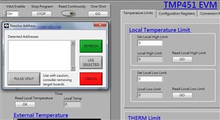

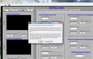

Customer reported our GUI is not working in Win7, as you can see below, there is no address can be found, 'refresh' does not work, if we click any other bottom, an error msg 105 will pop up.
Customer also tried other EVM like TMP1075, it works fine.
I believe this is driver issue, please kindly help timely, thanks.

    The link on the bottom of the TMP451EVM page is still a link to the old GUI for the TMP451EVM which used our SM-USB-DIG adapter. We have discontinued that version of the EVM due to the EOL of the SM-USB-DIG adapter.
    Please see this link for the current version of the EVM GUI: https://dev.ti.com/gallery/info/THSApps/TMP451EVM_GUI/ver/1.0.1/
    If they would like a local version of this GUI, they can use the arrow  on the tile in that gallery to download the GUI AND Runtime installation files as shown below:
    They can also run this version of the GUI in Chrome if they prefer. Either version should work with the new TMP451EVM.
