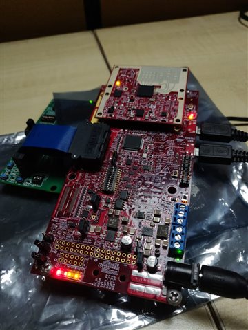

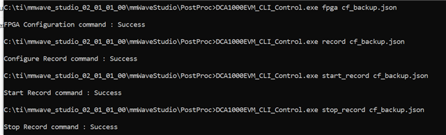

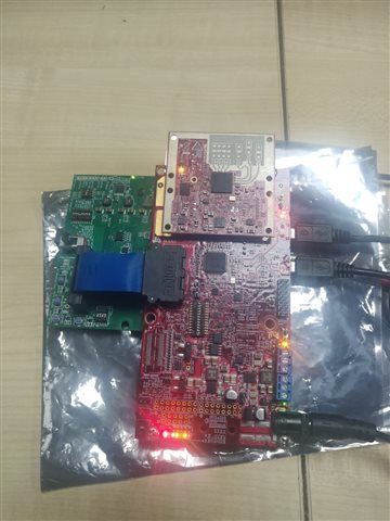

I was trying to capture raw data with TI-ISK6843 using CLI commands and followed all the steps mentioned in  TI_DCA1000EVM_CLI_Software_UserGuide(TI_DCA1000EVM_CLI_Software_UserGuide.pdf) .All the commands were executed successfully but as a result I didn't get the Binary file.
Hardware setup
Hardware Setup

CLI commands:-
