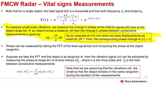

  • Mostafa,
    After discussing with our algorithm experts, they said the following:
    The phase values are related to the displacement by a constant factor  (4*pi/lambda) as shown in the highlighted slide below. Basically, whatever phase values we measure, we multiply by a factor (lambda/4*pi). In theory, this is the relationship between phase in radians and displacements in meter.
    That being said, the reason I had the displacement as “arbitrary unit (a.u)” rather than a physical unit e.g. mm, was that we are doing several pre-processing steps (i.e. phase difference, IIR filtering) on the phase values and I wasn’t able to relate the impact of these processing steps to the physical displacement.  For example, if the phase values are at the stop band region of the IIR filter, the filter would attenuate the amplitude of the signal but obviously the actual physical chest displacement is not decreased. If we want more exact displacement values, it can be done by analyzing the processing steps but that hasn’t been a priority as of now.
    Let me know if you have any further questions.
    Alec
    Q1. Even when there is no person on front of radar it the 2 displacement plot, inhale phase and breathing phase is changing as showed in the figure above. How do you explain that?
    In static environment the phase shouldn't change in phase neither location of range FFT, is that correct?
    Q2. can I convert from this arbitrary unit to mm unit inside Matlab?
