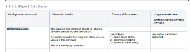

  • Seems like there is a call to rlSetContModeConfig in there because I set dfeDataOutputMode to Continuous mode. It's part of the SDK, so I didn't mess too much with it.
    I haven't changed anything related to the front end initialization starting from the high-accuracy lab, I just set 0 as chirp slope in the profileCfg command.
  • Continuous chirping mode is not supported by the mmw demo application.
    Please see mmWave SDK user guide
    Jitendra
  • Sorry Jitendra my bad,
    I set dfeDataOutputMode to 1, so it's frame-based chirps.
