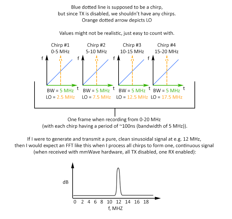

My current configuration is simple: I have a DCA1000 and an IWR6843ISK. I am doing research on the use of TI's FMCW radars as measurement devices. I am aware that this is NOT a typical way to use mentioned hardware.
For the reason mentioned above, I have turned off all TX channels in mmWave Studio, and I have turned on one RX channel, namely the first one (RX0). This works and I am able to do everything within the mmWave Studio software as expected.
I am curious about the RX/hardware behaviour in my scenario:
  • Firstly, if all TX channels are turned off, what is my RX mixed with? I am assuming an LO, but TI's FMCW fundamentals mention that RX and TX are mixed for each chirp.
  • Secondly, how does the LO behave for one RX channel, assuming that the RX and LO are mixed for each chirp?
    • Does the RX/LO "sweep", just like how a TX channel would transmit a synthesized signal? E.g. the LO increases linearly with small increments, like a modulated chirp would.
    • Or does the RX's LO "jump" for each chirp? E.g. the LO increments for each chirp?
I think that the latter (LO increments for each chirp) is true, but I am unsure. I have created an image to better express what I think is happening:
I have been going through the TI's FMCW fundamentals and the IWR6843ISK datasheet, but I was unable to find any information regarding my question.

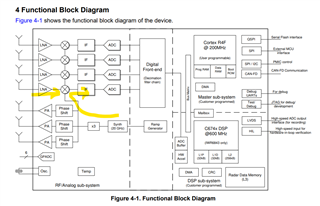

  • Hello Dante,
        As you could see in the block diagram, Even if the Txs are off LO would be fed to mixer, Here LO would be a ramp generator, same would be fed to mixer to generate the IF signal.  LO would increases linearly with small increments, like a modulated chirp would do.
    However in the RF Rx signal path there are no Tx signals coming back as a reflection you would get just noise.
    Could you please elaborate what is your ultimate motive of this question?
