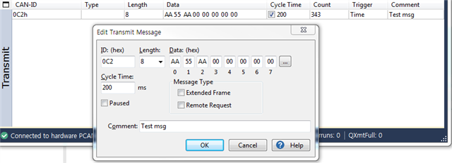

Sorry to answer now because work suddenly happened.
You can see setting of message ID filters on attached code.
I set message ID filter to 0xC2. Like this
    /* Setup the receive message object */
    rxMsgObjectParams.direction = CANFD_Direction_RX;
    rxMsgObjectParams.msgIdType = CANFD_MCANXidType_11_BIT;
    rxMsgObjectParams.msgIdentifier = 0xC2;
    rxMsgObjHandle = CANFD_createMsgObject (canHandle, &rxMsgObjectParams, &errCode);
    if (rxMsgObjHandle == NULL)
        System_printf ("Error: CANFD create Rx message object failed [Error code %d]\n", errCode);
        return -1;
And I changed PCAN Tx setting to like this
But I still haven't received the message.
