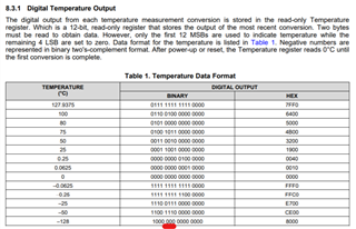

I found a clerical error in the datasheet.
Is it '0000' correct?
Also, please let me know if you have any plans to revise the data sheet.
