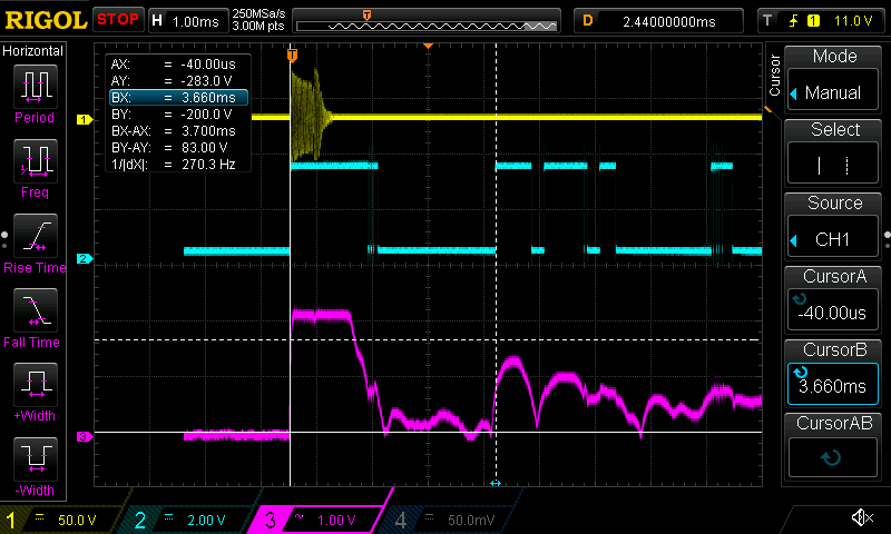

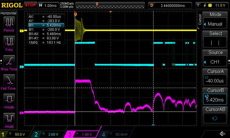

  • Hey Isaac,
    The time we are seeing is longer than expected.  From previous testing, we were seeing around 500us.  I did a test today to give you screen captures and am finding only 110-140us; I'm not quite sure why I don't see as much issue as before but still would appreciate your insight on what might be causing this.  Note that I did use a high accuracy thermometer to measure 70F in my test today, correlating with 13536 in/s.  For 24" this should be 3.55ms while we see 3.66 (110us, or 0.77" error) and for 36" this should be 5.32ms while we're seeing 5.46ms (140us, or 0.95" error).
    Here are the two captures.  Ch1 is the transducer, Ch2 is OUT4, and Ch3 is AOUT.  When zooming in I can confirm that there is minimal difference between when AOUT rises above 1V and when OUT4 rises.
    36"
    24"
    I appreciate any thoughts you have.
    Thank you,
    -Jon
  • Hello Jon,
    Thank you for the screen captures. I am glad to hear that the measurements are not that far off from where they should be. Have you attempted to change the value of the comparator threshold to see if that can trigger OUT4 at a more ideal time? It may be a little bit difficult if there is too much noise on the receiver.
    I did find something interesting on the data sheet regarding C_FLT, it seems like this capacitor can slow down the response time of the log amp. Perhaps adjusting this value could get you closer to the real ToF value you should be seeing on the comparator. I have attached the excerpt below, you can find it in section 7.3.4 of the datasheet linked here.
    Cinp and Rinp could possible also be contributing to the small delay as well. I know the 3k resistor is not needed and it only recommended for EMI noise immunity, not sure if you have the ability to replace this resistor on the board in order to test if the resistor is doing much in terms of delay but I suspect the capacitor might be the one doing most of the work on that end. Unfortunately I believe that capacitor is recommended to protect the input.
    Upon making some more exact measurements I am also observed a similar delay in my measurements but was slightly corrected when I fine tuned the setup. The issue with ultrasonic sensing is that there are a lot of mechanical variances that could be causing issues, in my scenario the surface which I was targeting was a little bit slanted and I assume there was some delay from when the sound waves were reflecting and reaching the transducer adding to my delay.
    But I believe if you can define the delay that you are seeing on your end you should be able to factor some of it into your final measurement in order to obtain a closer value.
    Isaac
