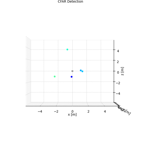

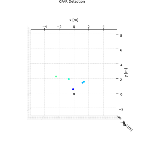

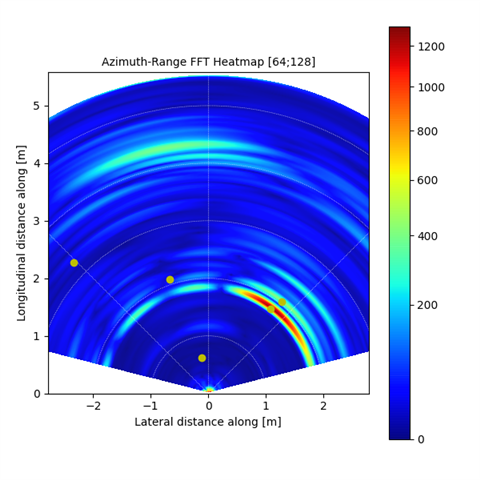

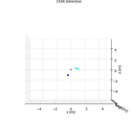

I've plotted the point cloud on the heatmap and found that the peaks have not aligned. What causes the peaks to not match?
Point cloud top view
Point cloud front view
Heatmap top view

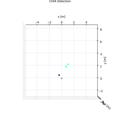

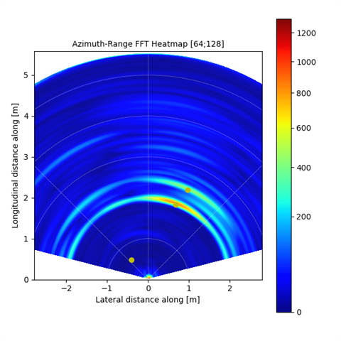

Heatmap top view

Hi Aleksey,
It seems that most of your points are correct. Are you running the sensor in a 2D configuration? Note that elevation is not considered in this plot.
The heatmap you have provided is azimuth only and does not consider elevation.
