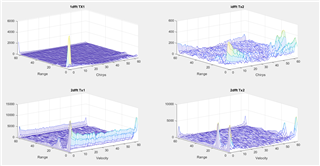

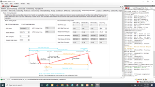

I and my team have been experimenting with changing profile configuration in the demo for xwr64xx in mmwave sdk version 3.5.0.4. I am looking at 1DFFT plot
and 2D FFT plots after capturing the radar cube data. I am running the following profile configuration:
tx start time: -8 us
number of adc samples: 50
freq. slope: 256 MHz/us
number of transmitters used: 2
number of receivers used: 4
ramp end time: 15.6 us
sampling freq.: 6000 ksps
other parameters suitably assumed.

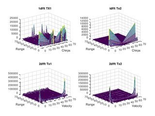

We are observing noise peaks near zero range bin in the 1DFFT plot of Tx1. However this is not there in Tx2's plot. The plot is of same Rx for both the Txs.
We are observing asymmetry in the plots of Tx1 and Tx2 for same Rx.
These noise peaks are changing w.r.t to time, i.e. the noise peaks are changing through successive frames even though my test object kept is at same place.
PFA plot of 1DFFT for Tx1 as well as Tx2.
Please let me know any reason for this strange behavior and how to solve this problem
