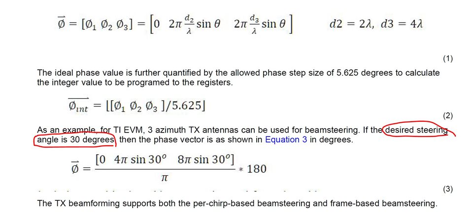

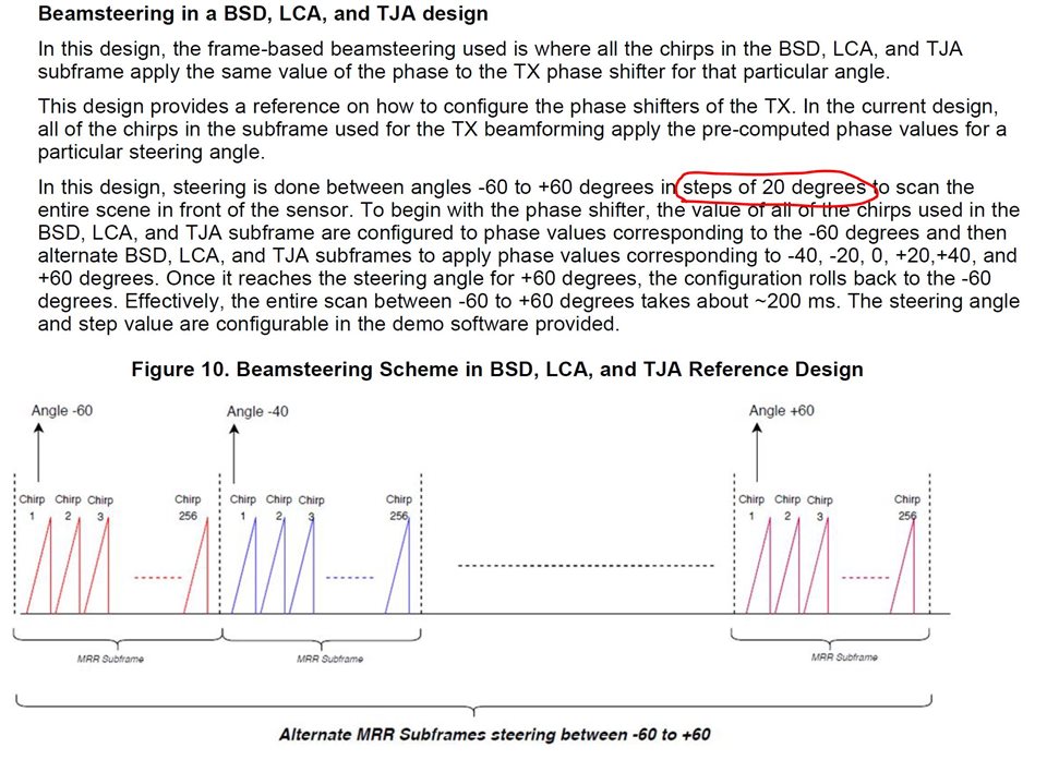

In Beamsteering for Corner Radar Reference Design
I am confused about the step size which is 30 degree in figure 1 and step size which is 20 degree in figure 2.
Q1. What's the difference between these step sizes?
Q2. How to set the step size and the steering angle between -+60 to -+80 just as an example in the firmware?

  • Hi, the step size is configurable. So it can be 20 deg as well as 30 deg.
    Please see Slide 21 in this document for information on how to change the step size.
    labs\lab0011_mrr_beamsteering\docs\mrr_2_0_Developer_Guide.pdf
    Notice that the FOV of the antenna will be a limitation even if you set the min/max Angle to +/-80deg.
    Please check the EVM UG for information about the performance of the antenna at +/-80deg
    thank you
