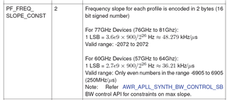

1、When i see the document of the datasheet of AWR2243, i find that the maximum ramp rate is 266MHz/us just as below
2、But when i see the document of <mmWave Radar Interface Control Document>, i find that the register can be configured  maximum 100MHz/us just as below for 77GHz radar
2072*48.279 ≈100MHz/us
So i want to check which one is correct? Thanks
