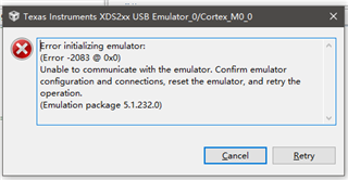

I use a new PGA900 on EVM and try to debug my code,but it occurs error.

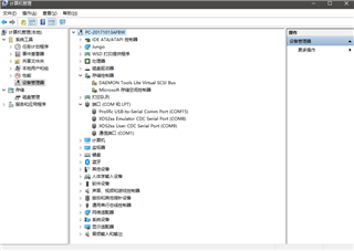

I checked my emulator drive, and check test connection, it seems ok.
It looks like you have 2 XDS200s in the device manager. Can you disable or disconnect one of them before attempting to debug with the other? Is this a problem that only shows up when debugging with one PGA900EVM but not another?
