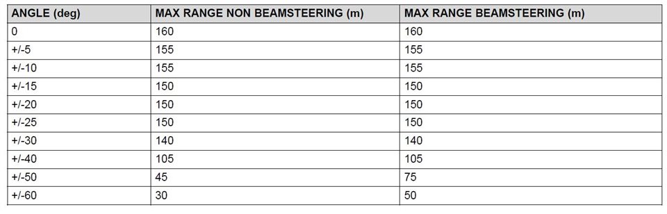

Is the only difference between Beam Steering and non Beam Steering the max range becomes greater in Beam Steering after +/-40 deg?
Are there any differences?

Hi Mostafa,
Apart from this, since beamforming is used, all three antennas transmit together. This reduces the number of virtual antennas from numRx*numTx to numRx. This will reduce the angle resolution. Apart from this, there should not be any fundamental differences.

We usually operate the radar by turning on 1TX at a time for each chirp. So TX transmissions would look like: chirp0(TX0) chirp1(TX1) chirp2(TX2) chirp3(TX0), ....
If only 1TX were used, the angle resolution would depend on the number of receiving antennae, roughly speaking. With the sequence of chirps I described above, we can get better performance, as we end up creating virtual antennae. This is the TDM-MIMO (time division multiplexing, multiple-in, multiple-out) concept.
With 4Rx and 2Tx working, we get the same angular resolution performance as we would have if we had 8 Rx antenna and 1Tx.
With beamsteering, we don't get this MIMO advantage, as all TXs transmit at the same time.

Hi Mostafa,
The purpose of the lab was to demonstrate beamforming and beamsteering. To form a beam at a particular angle, you need to have the TX programmed at particular phase shifts. These phase shifts do not correspond to the phase shifts needed by the BPM scheme, hence, we can't have both beamsteering and BPM.
So, while we could have used BPM to enable all TXs (and we have a configuration for that in the AWR1642 out of box demo), this would not give us beamforming.
When we use beamforming, the dB gain is even higher than if we simply enable multiple the TXs under BPM scheme.
Aayush
So the only advantages of Beam steering in mmWave radars is good ranges in maximum angles?
