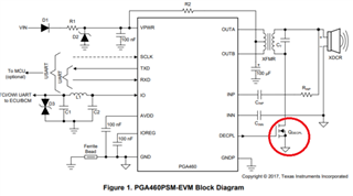

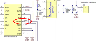

[Q2]
We are evaluating PGA460PSM-EVM.
However, we can’t find QDECPL on Schematics.
We understand that QDECPL is not implemented on EVM.
Is my understanding correct?
If yes, can I connect QDECPL to DECPL pin?
