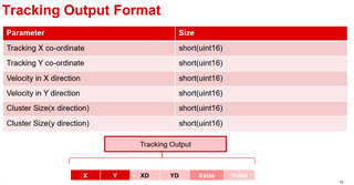

Hello Team,
Is there anyway to assign unique ID to a tracked object, as the data frame of tracked object keeps sending the following parameters as shown in below image dynamically, i cannot predict lets say In 1st frame no of obj detected = 1 and its vel is 100 m/s, and in 2nd frame no of obj = 2, and in 3rd frame no of obj = 4 and so on
As you can see in 3rd frame we have 4 objects. so object 1 parameters can be in any of the index (index 3 in third frame, index 2 in second frame and so on)
What factor i can consider so i can assign unique id to the tracked object (That i can print its id on visualizer).

    I checked with algorithm developer. You would need to add ID in the Tracker State structure.
    Then you would need to increase the value of the ID when a tracker is created
    Something similar to below

    typedef struct KFstate
        Uint32_t ID;
        uint8_t age;
        uint8_t tick;
        uint16_t validity;
        int16_t xSize;
        int16_t ySize;
        float vec[N_STATES];
        float covmat[N_UNIQ_ELEM_IN_SYM_COVMAT];
    }KFstate_t
    void createNewTracks(MmwDemo_DSS_DataPathObj * restrict dataPathObj,
                         trackingInputReport_t const * restrict measArray,
                         int16_t const * restrict freeTrackerIndxArray,
                         int16_t const * restrict selectedIndxArr,
                         const int32_t numSelected)
        trackingInputReport_t const * restrict currMeas;
        KFstate_t * restrict currTrack;
        int32_t iTrack;
        int32_t freeTrackIndx;
        int32_t selectedMeasIndx;
        for (iTrack = 0; iTrack < numSelected; iTrack++)
            freeTrackIndx = freeTrackerIndxArray[iTrack];
            selectedMeasIndx = selectedIndxArr[iTrack];
            currTrack = &(dataPathObj->trackerState[freeTrackIndx]);
            currMeas = &(measArray[selectedMeasIndx]);
            initNewTracker(currTrack, currMeas);
            currTrack->age = 0;
            currTrack->validity = IS_VALID;
            currTrack->tick = 0;
            currTrack->xSize = currMeas->xSize;
            currTrack->ySize = currMeas->ySize;
            currTrack->ID = global_ID_track++; //keep increasing don’t recycle define as uint32
