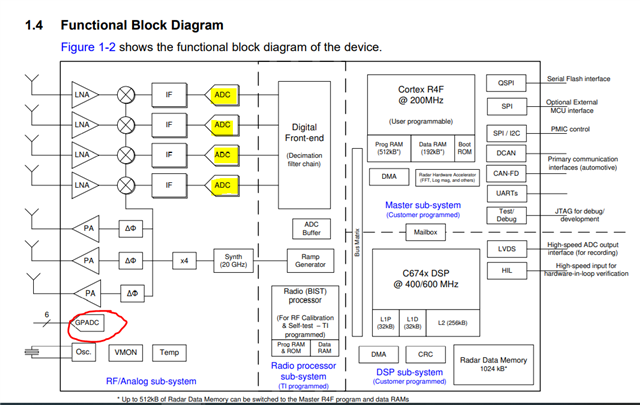

HI Ishita,
Thank you.
it's Ok for the mixer, I am in a puzzle about datasheet, Can you explain it?
The sampling rate of A2D in RF specification of page 30 is 25Mbps and A2D resolution is 10MHz.
On the other side, the ADC sample rate of page 64 is 625ksps and the resolution is 10bits.
What's the difference?
Thanks.
Hello Frank,
These are two different parts you referring to here.
If you refer to the device block diagram in the datasheet (i.e. Figure 1-2) as seen below :
1. The highlighted components in yellow correspond to the ADCs in the receiver chain for sampling the data coming from receivers. The specifications in the RF Spec table correspond to this ADC
2. Now coming to Section 6.4.1 in the datasheet, it corresponds to the GPADC (highlighted in red) available for user application for external voltage monitoring purposes.
Hope this makes sense now.
