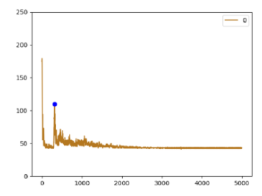

I designed a board based on STM32L433CB, and TUSS4470 (schematics attached below).

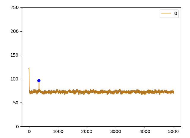

I have serious problems measuring at 1MHz, see screenshots below.
ADC is configured to sample at 32MHz, seen on the image the raw sampling through Vout pin processed by the ST-MCU.
I assume that the issues are related to FLT, INN capacitors, but I couldn't find any configuration where I can have similar results to those ones on the external BOOSTXL-TUSS4470 setup.
I'd love to have any idea about the design and how we can improve it and achieve better results using our custom-designed board.
TUSS4470 Schematics -

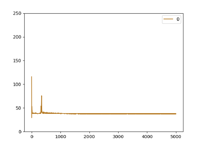

Reference Taken From STM32L446RET and BOOSTXL-TUSS4470 (1MHz Transducer) -

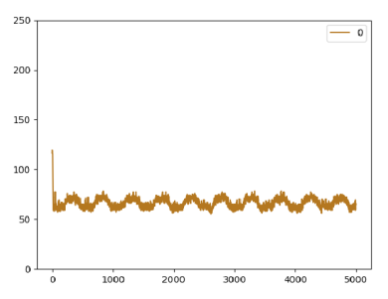

Custom board(1MHz Transducer) capacitors(CINN and FLT) as Noted on Datasheet and Schematics Above -

  • Hello Itamar,
    It is possible that it could be the CINN and FLT capacitors, although those capacitor values might have worked perfectly on the BOOSTXL-TUSS4470 its possible the new custom board might be sensitive to these values. I calculated what should be the correct values these using the formulas found on pg. 31 of the datasheet and got smaller values ~600pF for C_FLT and ~4.2nF for C_INN. They might not be perfect but maybe a good starting point for reducing the noise.
    What I believe may be the main issue though is that I do not see any separation of the grounds in the schematic. Section 10 of the datasheet contains layout guidelines where it mentions (top bullet) that separating the ground types is key to reducing noise at the AFE:
    The list does contain other guidelines that could be part of the problem. Not sure if you have taken a look at this before but I hope this helps!
    Isaac

  • Hello Isaac,
    Without jumping straight to conclusions, I think that in the transition from the ST development board to the customized board, I had an issue with the SPI protocol implementation, which caused the component to not configure properly.
    On an open-air setup, it seems that it eliminates the ground noise, probably because of the internal HPF configured by the SPI, I will check it underwater in the next few days and update.
    But if that is the case then I believe it definitely could be ground noise affecting the ADC values. That or not enough capacitance at for C_FLT, I tested today with almost no capacitance and the noise floor did rise up but it looked different from the plot that you provided.
    Just for my general knowledge, CINN should remain according to the datasheet calculation of ~4.2nF, and FLT is the capacitor should be changed according to internal impedance due to my design?
    Itamar

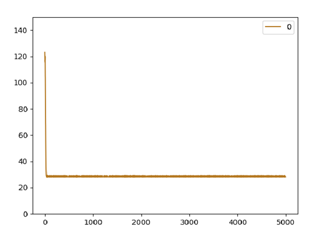

    Using the battery as input, results are stable:

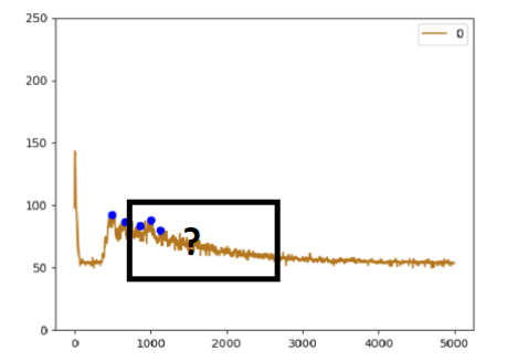

    Additionally, somehow on both custom setups, I get the following result:

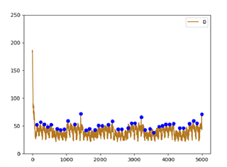

    Using the second option, all three setups are barely usable, when the transducer is placed outside of the water the baseline is flat without any noise. When placing the transducer in water, the TUSS4470 baseline raises and gets very noisy:
    I succeed in filtering out the signal using the internal HPF/BPF configurations, capacitors changing which causes the baseline to be more stable, but there is no way to detect the returned echo on such signal (signal is expected to be the same as the first image).
    Any idea/thoughts?
    Thanks.
    Itamar

  • Hi Isaac,

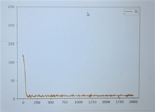

    Results are much better with a slitghly different registers configuration. My customized board gives great results operating on 24V battery as power source:  When i power the board using power supply from wall charger (24 VDC), i get the following results:
     I assume that if I apply a proper filtering on the power input i will have relatively good results.
    On the next revision, I will improve the ground isolation as suggested on the datasheet.
    Thanks for the help!

  • Hi Isaac,
    The strange behavior of the boards continues, when touching the transducer the 1MHz transducer with my hand in the open air, which I assume is the closest to being inside of a pool, there are completely different behaviors when operating under the battery and under power supply (AD-DC).
    It happens on both BOOSTXL-TUSS4470 and my customized board.
    Power Supply (24V):
    Battery (24V):
    Any idea what can cause this issue?
    Thanks.
  • Hello Itamar,
    When you touch the transducer with your hand what happens exactly? Are you seeing a rise in noise floor from the power supply vs the battery? I do not have much suggestions for the issue since I do not have plots when your has is not in the way, if you could provide some more info and plots that should be helpful.
    Isaac
