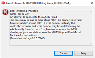

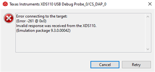

The debugger also has this bizarre behavior where if the target is disconnected or loses power while debugging, I not only have to unplug the XDS110 from my computer, but I also have to restart CCS in order to get debugging to work at all. When reconnecting power and trying again immediately after failure, this error occurs:
Then if the XDS110 is reconnected, you get this error:
Which won't go away until CCS is completely restarted.

  • Abram:
    With regards to power cycling or disconnecting from target while debugging I connected one of our EVMs, IWR6843AOP, ran the OOB demo. To start a another debug session you have to issue a CPU reset, then reload the binary to start another debug session. Otherwise you need to stop the current debug session, press NRST switch on the device, launch the configuration file, connect to target, load binary, and run. Can you try these steps on with your setup? Also do you have an evaluation board?
    Connor
  • This is the only CPU reset I can find within CCS during debugging. It seems like it just does a "soft" reset since it just immediately runs the binary I had loaded and crashes. It does not appear to run the debug binary, which as I understand it, MUST be run before starting any debugging session.
    Is the XDS110 capable of asserting NRESET on the JTAG connector? Is there a setting to enable that?
    That said, this doesn't fix the issue. If power to the board is lost OR the chip is reset whilst CCS is connected to the debugger/IWR6843AOP in an active session, CCS MUST be restarted, and the XDS110 MUST be disconnected and reconnected to the computer. I can't even start a new debugging session. The issue isn't that I don't know how to avoid this since I just need to stop the debug session before hitting reset, as you mentioned. Are you not seeing this behavior?
