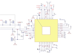

And then I replace this pga900 from EVM on my own pcb.But i couldn't get UART output while power on my pcb.
I designed my pcb reference from EVM users' guide like below.
Because I only use PADC and UART, some pin i disconnet.Here is my pcb.
Now I am wondering whether I miss some pin to connect as I want to run a otped pga900 on my pcb.
    The main issue is that DVDD_MEM (pin 2) is left floating. This pin powers the EEPROM and OTP memory, and must be connected to the DVDD pin. I also recommend tying the AVDD and DVDD (+DVDD_MEM) pins to ground through a 100nF capacitor close to the PGA900 device. Typically you would also use a decoupling capacitor at the VDD input as well,  but it can be a much smaller capacitor in the case where you intend to use OWI communication since extra capacitance can affect the edges of the OWI signals. When using OWI a 10nF capacitor is sufficient, but if you do not use OWI 100nF would work well.

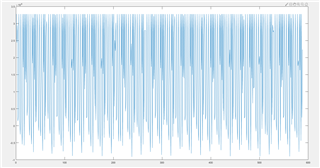

    For my PCB ,the voltage input is 50mv DC generated by a waveform generator.And i checked the powre for pga900, the DC 5v is generated by a LDO that should be steady.The pga900 on my pcb has been OTPed and I have verifyed and it worked well on EVM as I power on EVM it can output uartdata expectedly.The otped pga900 is configured as UART output, 5 gain on P channel and 16bit ADC.
    I receive my uart output and do curve plotting in matlab.

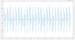

    This is my PCB outout plotting.It change acutely unexpectedly.
    Then I put the same pga900 on EVM,for the same input voltage,and do curve plotting in matlab again.This time it worked well.
    So i wonder why the same OTPed pga900 worked differently on my pcb and EVM.Is there still something I missed in my PCB design?
  • Hi Gibson,
    I also recommend grounding the GATE pin if you are not using it. My apologies for leaving that out. I would recommend checking against the schematic for the EVM with respect to the unused input pins. The output pins are less essential and can be left floating.
    Scott
  • There are a few input pins like COMP pin13,CSN pin29,FBN pin11,FBP pin12 and etc some inpu pins I didn't use.Should I also conenct them like schematic for the EVM?

    This time the output data didn't change sharply like befor.This time the output changed from -2000 to 5000 that is better than make GATE pin floating.
    But in EVM it changed from 3200 to 3350, the resoult on EVM is more accurately.And I wonder the reason and improve the same pga900's behavior on my own PCB.
