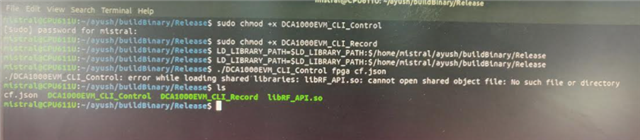

We are trying to capture raw data via CLI commands in lInux using DCA1000.While running the executable file we got the following error.We followed the TI_DCA1000EVM_CLI_Software_UserGuide.pdf document.

Ayush,
Please follow the "DCA1000EVM CLI Building Instructions" section of the DCA1000EVM CLI Software User Guide which is included in the mmWave Studio installation folder. Specifically, please refer to section 4.2 that discuss this within a Linux context. You may need to build some of the files needed for execution in Linux first.
This User Guide can be found in this folder location:
C:\ti\mmwave_studio_02_01_01_00\mmWaveStudio\ReferenceCode\DCA1000\Docs
Kyle
