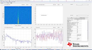

I'm trying to get the IWR6843ISK running to try different ramp parameters to fit our application. I have all hardware connections running (2 USBs and Ethernet) and it works seemingly fine in mmwave studio. Post-processing the results however, nothing on the received signal doesn't really change except a little bit the noise. The sensor doesn't detect any targets, neither any defined radar reflectors. With the software it seems to go through all the correct motions. The result looks like the TX is actually not transmitting.

Processing result

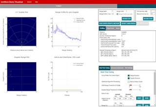

Do you have any idea where I'm going wrong (any parameters to be changed, any DIP switches not OK)? The card works well with the Demo Visualizer.
Demo Visualizer Result

    Your ADC samples looks fine to me in your radar studio post processing results.  I am not sure which makes you think there is no transmit.  You can ignore the angle estimation results in radar studio because there is no antenna information provided to the radar studio.  The post processing in radar studio should be good for ADC data, range FFT, range-Doppler heatmap information.
    Zigang
  • By the way, the LED in your DCA1000 seems to indicate you are using a SD RAM for data capture.  In that case, I am not sure the data will be transferred back to PC for radar studio to process.   You may need to remove the SD RAM on your DCA1000 board.
    Zigang

    thank you for your answers. What I meant when I said that it seems like the TX might be off is that the results look exactly the same with nothing in front of the sensor or with a 100m2 radar reflector in front. Looks like noise floor only. Anyway, I removed the SD card and nothing changed. I noticed however that the adc_data.bin file doesn't update. In fact I forgot to connect to the DAC1000 via Ethernet, that was a stupid mistake, sorry for that. Now it is updating the adc_data.bin file but I get an error message when starting the post processing (incorrect number of samples):
