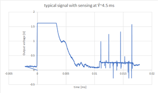

We made a design using the recommendations in the TUSS4470 datasheet but the ringing is too high. We use a ProWave 400EP14D ultrasound sensor which can both emit and detect.
We use maximum amplifications as our signal is very weak. We use the analog output and make our own discrimination. However, the output is saturated up to ~3 ms and then decreases roughly linearly to 0 in another 3 ms. (in the above graph the signal is limited by the oscilloscope to 1.6V. We tried to change the number of pulses from 20 down to 8 without any change in the first peak. The excitation voltage is set to 20V. On the above graph you can see the signal coming back from the object just below 5 ms. We would like to be able to detect objects at ~25-30 cm which means below 2 ms. How can we improve our design?

    I will upload the ringing of the sensor. I was convinced until yesterday that this is the problem, but I have big doubts. We changed the number of pulses from 4 up to 20 and could not see any change in the first envelope. Indeed, the burst lasts few hundred us, the ringing seen on the oscilloscope another 200 us but the peak signal on the output is nearly 6 ms. I wonder if the LNA does not get saturated with the peak signal or the filtering capacitor is too big? We are going to verify these two ideas. I will also follow the recommendation to reduce the drive voltage from the current max value to maybe 10V. We played with the damping resistor at the beginning of our project. This is how we got to the 220 Ohm. This is already quite small.
    Could one of the filter settings enlarge the signal to the extent we see?
    Our initial peak spreads much more than the one in your datasheet.
    We also tried two completely different sensors: one symetrical and the other asymetrical. They are different in size, in sensitivity but the initial envelope curve was the same for both. We even implemented an algorithm to substract a slope from the signal to remove a large part of the peak. It is efficient when the peak is small but we could not detect anything below ~3.5-4ms. The shape is very reproducible. We tested several TUS4470 and several sensors and the differences were on the scale of 5%.

    We made a lot of testing on Friday. Indeed, the ringing is the issue. As it is decaying very slowly, 1st it was difficult to observe. We tried to change the Cflt value reducing it from 15nF to  2.2 nF. This was not a good idea as it only removed the filtering of the 40 kHz. We changed the number of pulses from 16 to 4. This helped reducing the saturation by ~0.5 ms. It went in the right direction but at the same time, the signal intensity became too weak.
    We then changed the different amplification options. As the signal to noise ratio due to the ringing is very bad, the amplification had no real effect.
    We also varied the damping resistor. Our original value between 220 and 360 Ohm seems to be the optimum.
    Finally, we tried to put a single pulse 180° out of phase after the 4 initial pulses. Unfortunately, the Piezo sensor is "too good" and although we reduced the oscillations intensity but now the decay was slower so the effect was very small. Probably, we would have to develop a special pulse which is just enough to absorb the oscillation energy. Should we try? Not very easy with your chip.
    Today, we received the evaluation board from ProWave. They use an adjusted transformer. The signal was beautiful. We could detect easily objects down to less than 25cm. Their drive method is also described by your datasheet (an external transformer pumps up the voltage on the sensor). I can understand that the signal is bigger because we have 140Vpp instead of 36Vpp but I cannot understand why the ringing is so small. We could do the same with the Tuss4470. However, I am afraid that we will have to adjust each driver to the correct impedance. Is there a way to go around the transformer technique? Maybe using an inductance? (We tried 10 mH in parallel with the sensor without any effect even if this would give ~40 kHz resonance frequency with the sensor)
