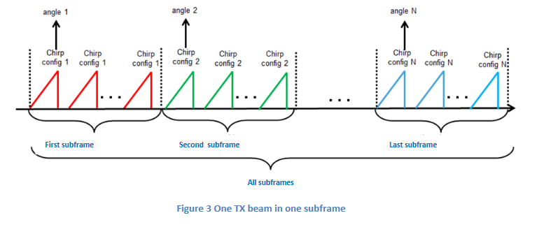

Hi teams,
I want to enable beamforming in IWR1843BOOST. My current setting is one beam in one sub-frame but I want to configure it as multiple beams within on sub-frame like the figure below.
Besides, how can I parse the raw ADC data if this configuration works.
Warm regards,
Xi
  • Hello Xi,
    It seems that you referenced that image from the document "Enabling Tx Beamforming" in the Industrial Toolbox. Is that not sufficient?
    Though it is NOT specific to beamforming, there is an example cfg for setting up advanced subframe provided in the mmWave SDK. After installing the mmWave SDK, you can find this example here: C:\ti\mmwave_sdk_03_05_00_04\packages\ti\demo\xwr18xx\mmw\profiles\profile_advanced_subframe.cfg
    Unfortunately, collecting raw ADC data for multi-chirp format is not supported.
  • Hi Sabeeh,
    There are actually two types of beamforming in the doc, but only the second type has example. The configuration file you mentioned in SDK folder is also the second one.

    I am still wondering how to set up the first type beamforming shown in figure in my original question.
    Kind regards,
    Xi
  • Hi Xi,
    I understand your point. You would like to see an example chirp configuration for the figure you have posted. Unfortunately, this is not possible with the current mmWave SDK. It would require significant changes to the processing chain. Therefore, the configuration (as shown in the image below) is possible.
    I hope this is clear.
  • Section 6.1 of the app note, "Programming Chirp Parameters" discusses this in some more detail if you are still curious.

  • Hi Sabeeh,
    In your first response, "collecting raw ADC data for multi-chirp format is not supported" refers in particular to "Chirp based beam steering" that has multiple chirps in one subframe. Although, you can use this setting, the collection of raw ADC data will not be working. Is my understanding right?
    Warm Regards,
    Xi
  • Yes, Xi, you are correct.
