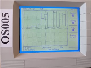

I am currently working on the PGA305 and  I am both reading & writing EEPROM correctly (good news ;-) )
Unfortunately, I have still an issue with output signal and I think that my error comes from PADC GAIN & TADC GAIN
For example, Here are my settings to only read internal Temperature :
DAC_CONFIG = 0x00 (Absolute)
 T_GAIN_SELECT = 0x02 (5V/V + no inversion)
TEMP_CTRL = 0x43 (Internal temperature + OFF)
TEMP_SE = 0x00 (Single ended)
coeff. H1 = 0x200000 = 0.5
All other coefficients = 0x00000000
TADC= 0x1CFFB9 = 0.57 V (21.78 °C)
TADC_GAIN = 0x32DCD5
TADC_offset = 0x000000
DATA_OUT expected = DAC_GAIN (H1*TADC*TADC_GAIN) = 4*(0.5*0.57*1) = 1.14 V
but results are very different, output signal is unsteaddy, see oscilloscope results:
Waiting for your feedback regarding my results...Is there any tests to perform?

  • Hi Bastien,
    Your TADC_GAIN value is very high. The number in TADC_GAIN is directly used as the gain, so I would expect it to be set to 1 most of the time. This is likely causing large fluctuations in the output with minor changes to the temperature. Does the output appear to respond to temperature like you would expect? If you place your finger on the PGA305 device does the output increase?
    Scott
  • Hi Scott,
    Thanks for your feedback. There was a misunderstanding from our side aout  the Gain value (T & P).
    We though it was a coefficient coded on 3 Bytes like ho, h1, etc. .
    We had fit the coefficent to 1 and it xorks well.
    Kind regards
