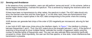

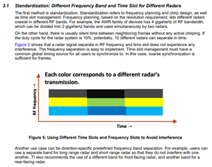

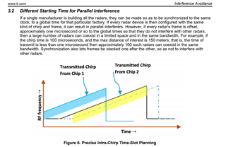

I would like to know if there is a way to connect two IWR6843ISK sensor & DCA1000 pairs and use them in sync.
Please guide me on the HW method to synchronize two sensors (the HW sync port exists so that the two sensors can be connected) or the SW method (there is a slot for sync and how to use different slots). .
We want to detect an object using data separately sensed by two sensors.
