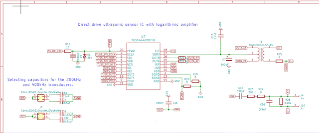

TUSS4440: [Software and Hardware] Not exciting transducer
Part Number: TUSS4440
Other Parts Discussed in Thread: TUSS4470, MSP430F5529, ENERGIA
I have been breaking my head over why TUSS4440 is not exciting the transducer, I am not able to spot the issue. The schematics look the following:
I am trying to perform a simple TOF measurement, and convert it to CM based on the examples provided by TI and also here. The frequency on the IO2 pin is set to 200Khz which shows up on the osciloscope, the SPI settings are also default ones.

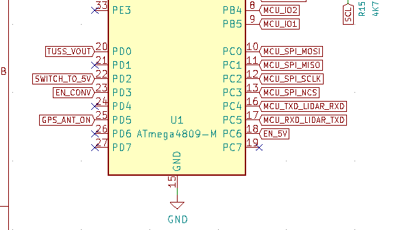

void initializeTUSS4440() {
TCB2_Initialize();
TUSS4440_Initialize(); // initialize SPI communication for ATmega4809 -> TUSS4470
// initTimer(); // initialize timer for 1MHz pulse
// initSPI(); // initialize SPI communication for MSP430 -> TUSS4470
// initADC12(); // initialize ADC12 A/D converter in MSP430F5529
initTUSS4470(); // initialize/configure TUSS4470

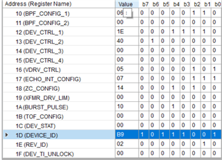

void initTUSS4470()
// recommended TUSS4470 register settings from INDUS_REG_USER_MEMSPACE_447-StemincTDCXDCR_Optimized.txt
// e2e.ti.com/.../927400
writeRegTUSS4470(0x10 ,0x5F); // (BPF_CONFIG_1)
writeRegTUSS4470(0x11 ,0x00); // (BPF_CONFIG_2)
writeRegTUSS4470(0x12 ,0x1C); // (DEV_CTRL_1)
writeRegTUSS4470(0x13 ,0xC1); // DEV_CTRL_2)
writeRegTUSS4470(0x14 ,0x00); // (DEV_CTRL_3)
writeRegTUSS4470(0x15 ,0x00); // (DEV_CTRL_4)
writeRegTUSS4470(0x16 ,0x40); // (VDRV_CTRL)
writeRegTUSS4470(0x17 ,0x07); // (ECHO_INT_CONFIG)
writeRegTUSS4470(0x18 ,0x14); // (ZC_CONFIG)
writeRegTUSS4470(0x19 ,0x00); // (XFMR_DRV_LIM)
writeRegTUSS4470(0x1A ,0x08); // (BURST_PULSE)
writeRegTUSS4470(0x1B ,0x02); // (TOF_CONFIG)
writeRegTUSS4470(0x1C ,0x08); // (DEV_STAT)
writeRegTUSS4470(0x1D ,0xB9); // (DEVICE_ID)
writeRegTUSS4470(0x1E ,0x02); // (REV_ID)
writeRegTUSS4470(0x1F ,0x00); // (DEV_TI_UNLOCK)

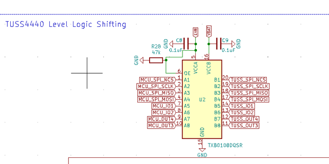

//// write register values to TUSS4470 over SPI bus ////
void writeRegTUSS4470 (uint8_t address, uint8_t value) {
uint8_t *regValPtr;
uint8_t tuss4470regWriteArray[2];
regValPtr = tuss44x0_regAddParity(address, value);
tuss4470regWriteArray[0] = *regValPtr;
tuss4470regWriteArray[1] = *(regValPtr + 1); // increment pointer 1 byte
//Enable SPI module
TUSS4440_Enable();
spi0_configuration_t t;
t.CTRLAvalue = 0;
t.CTRLBvalue = 16000;
TUSS4440_Open(t);
//Wait for slave to initialize
_delay_ms(100);
//USCI_B0 TX buffer ready?
clientSelect();
TUSS4440_WriteByte(tuss4470regWriteArray[0]);
TUSS4440_WriteByte(tuss4470regWriteArray[1]);
clientDeselect();

Any help is greatly appreciated!
  • Hello Philip,
    Thank you for the information I will have to review it in case if there is something you may have missed. But just to check you said you have been able to confirm if the IO2 pin is receiving the proper signal on the scope. Have you been able to probe what the output is on OUTA and OUTB after you process a pulse command?
    Isaac
    thank you for your swift response. So the code is easier to debug, i rewrote it to the C++ example from here. This is the code (i could not format it as code, some error pops up):

    The PB2 pin is the IO2 pin on TUSS, it is correctly being triggered. There is no signal on the OUTA and OUTB pins, and the code hangs on this method, as it awaits some input:

  • Hello Philip,
    Sorry for the error, do you know what error message it generates so that I may report it to the team so that we may get that fixed?
    So you have confirmed that IO2 is being generated by the MCU? You should see a square wave being generated as an output at the frequency equivalent to the operating frequency of your transducer. Have you monitored the VDRV_READY bit to see if the capacitor in the device has charged and reached the required level?
    Are you using the MSP430F5529 as an MCU for your project? Or are you using a different microcontroller?
    Isaac
  • My setup is the following: ATmega4809, a voltage translator and TUSS4440 is being driven by 20V on the VPWR pin, the VDRV pin is not being driven after starting the burst
    That is correct, the osciloscope is showing the IO2 on TUSS4440 being driven the proper amount of times, there is no movement on the OUTA/OUTB pins. While reading the 0x1C register (7.6.1.12 DEV_STAT Register (Address = 0x1C) [reset = 0x0]) I am receiving this value: 10111001. As I understand it, this means that the VDRV pin has the correct voltage but there is a CRC error. What should be the next step to be able to find where the issue lays? This is the method used to read the register:

    Those are the current readings from my register:
    No. Register Value
    1 0x10 10100001
    2 0x11 10100010
    4 0x12 10100100
    5 0x13 10100111
    6 0x14 10101000
    7 0x15 10101011
    8 0x16 10101101
    9 0x17 10101110
    10 0x18 10110000
    11 0x19 10110011
    12 0x1A 10110101
    13 0x1B 10110110
    14 0x1C 10110110
    15 0x1D 10111010
    16 0x1E 10111100
    Please tell me what else I can provide you so we can pin down where the issue is. The IO2 is properly driven, 20V is being applied to the device. I am using a 200kHz transducer, the INN capacitor is 21 uF, the FLT is 31.83 uF. I do not see anything on the OUTB/OUTA and VDRV pins. I am not sure how to debug the TUSS4440 further.
  • Hello Philip,
    Thanks for the files, I will look through them to see if I can find the issue, but there definitely seems to be an error in reading the register because the value for the device ID is not correct (register 0x1D should be yielding a value of 10011001). My belief is that the problem is most likely in the code so I will take a look at that for you just give me some time to review.
    On another note the values you are using for your capacitors a 200kHz transducer and IO2 being driven at the same frequency are  significantly high, if you look at table 21 of the datasheet it gives you the formula to follow for your transducer frequency I obtained a value of 3.18nF for C_FLT and C_INN I obtained 21.22nF. You can also refer to this thread here if you are curious about other values: e2e.ti.com/.../boostxl-tuss4440-missing-documentation-to-set-frequency
    Isaac
  • Hello Isaac,
    thank you so much for pointing my mistake in my calculations! I exchanged the capacitors!
    I hope you will be able to find the issue that is not allowing to correctly communicate with the device through SPI!
