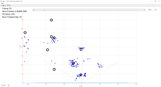

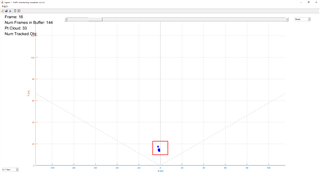

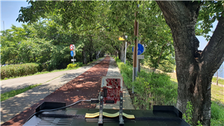

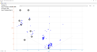

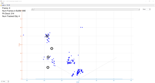

    I read example file you recommended, but It isn't include how to mitigate False Detection. The example file says "by intelligently grouping and tracking the detected points, the software can successfully track the human without tracking the trees and shrubs". Is that means Gtrack software is already can track the human without tracking trees and shrubs?
    In my test case, The object tracking the human remained on the points of the trees or sometimes objects are allocated due to points of the trees.
    Below case is that object tracking the human remained on the points of the trees.
    Initially there are only points of the trees.
    Human pass by and the tracker starts tracking human.
    After the human passes by, the objects remain at the points of the trees.
    Those objects will remain until the tracker terminates. please advise on how to solve these false detection.
    Thanks.
    The tracker might retain the points for few frames before it can confirm to remove the objects from the scene. This could be the reason for having latencies.

    Modifying the stateParam values will change how quickly the tracks are released. I would not set these values to 0, but 1 frame might be acceptable if you expect the tracked people to be moving the whole time.
    Also, in the top of the post you modify the boundary box, but in the GUI screenshots it looks like there are tracks created well outside of these bounds. Are you still using the boundary box when running this? This should help to filter some of these tracked objects.
    There is no feature in gtrack right now to classify whether there is a human or tree/shrub. You may be able to eliminate some of these tracks by modifying the allocationParams or gatingParams. Please see the below document for more info on these.
    There was an error in that test. The test was run with the Long Range People Detect 100m 2D example, but I adjusted the height values of the bounding box and sensor. I'll try run with 3D example to filter some of objects.
    Is it helpful to adjust gatingParams in cases(as mentioned above) where human-tracking objects remain at points in the tree, or sometimes objects are assigned due to points in the tree?
    Thanks.
  • It might help to reduce the gating parameters, as the points from the tree should not be added to the person unless they are so close. But, if the person is walking very closely to the tree then it will very difficult to distinguish between the person and the tree.
