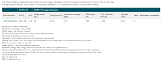

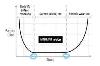

According to the datasheet it seems the expected life of the sensor can be affected by the environment of the sensor during operation.
Operation for extended periods of time at the extremes of the stated humidity measurement range could establish an offset but could also affect the life of the sensor.
I also understand particulate like dust could affect the reading and could also affect lifetime. In addition, exposure to too much heat during soldering and exposure to volatile contaminants in the air could also shorten the life of the sensor.
My question: is there a nominal expected lifetime or lifetime curves related to atmospheric conditions near the sensor?
Will this sensor last 5 years? 10 years? 15 years?
