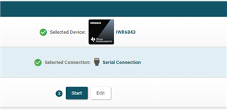

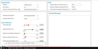

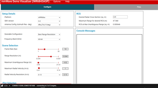

when I connect the IWR6843AOP, use the web to test the Demo project, but no data on the web.
How to fix it?

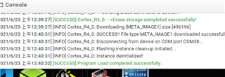

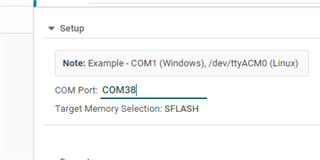

Which demo did you use to flash the device? And are you sure the device is in functional mode?

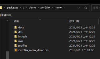

I did not show the Console Message "about the SDK version"
and I use mmWave SDK Demo 68xx Aop.
You are using binary from 68xx, which is incorrect for this demo. You need to use binary from 64xx directory.
packages/ti/demo/xwr64xx/mmw/
xwr64xx_mmw_demo.bin
