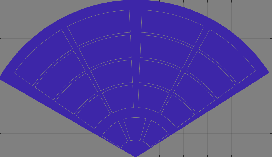

I maximized number of zones in Front mount Occupancy to 19 inside Matlab as following but when modify od_demo_18xx_8zone.cfg, it gives me error message when I run the example.
My application is to get decisions of occupancies in a whole polar map.
 How could I modify number of zones in config file?
         zoneDef= {[7,10,1,14],[7,10,17,14],[7,10,33,14],...
                   [20,10,2,11],[20,10,13,11],[20,10,25,11],[20,10,36,11],...
                   [30,10,2,11],[30,10,13,11],[30,10,25,11],[30,10,36,11],...
                   [40,10,2,11],[40,10,13,11],[40,10,25,11],[40,10,36,11],...
                   [50,10,2,11],[50,10,13,11],[50,10,25,11],[50,10,36,11],...
                   [9,10,8,32],[24,10,8,32]};

    The only change I did in "od_demo_18xx_8zone.cfg" is:
    zoneDef 21  7 10 1 14  7 10 17 14  7 10 33 14  20 10 2 11  20 10 13 11  20 10 25 11  20 10 36 11  30 10 2 11  30 10 13 11  30 10 25 11  30 10 36 11  40 10 2 11  40 10 13 11  40 10 25 11  40 10 36 11  50 10 2 11  50 10 13 11  50 10 25 11  50 10 36 11  9 10 8 32  24 10 8 32
    Is that true?

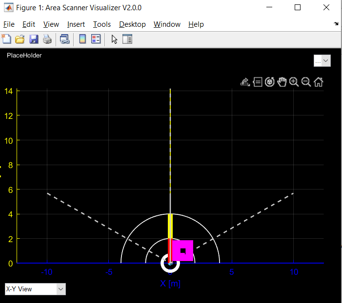

    Regarding Area Scanner demo, User guide says this lab runs on AWI6843ISK, AWI6843ISK-ODS and WI6843OAP
    AWR1843 not mentioned
    I tried to run this demo on AWR1843 using Play Back mode and didn't work.
    This fixed view I get from visualizer.
    Can you guide me how to port the Area Scanner to AWR1843?
