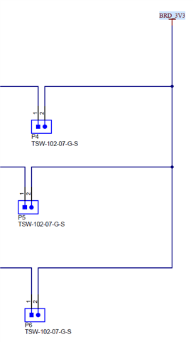

Looks like there is power issue with the carrier board. when it is powered, only single LED D8 ( NRST) keeps on blinking.
attached image of the board, when it is powered ON.

All the boards would be tested for it's functionality before it's gets shipped from TI factory. Could you please share better image of full board top and bottom side of the board.
Potentially 5V to 3.3V might have been damaged, as 3.3V LEDs are not showing up, on the bottom side of the board LEDs. Could you please elaborate what happened to this board? was there any 12V or any other power adapters applied to board? or any incidents happened to board?

12V adapter connection is not possible, but I cannot be completely sure. No other incident has happened.
attached the better image of board from top to bottom.
Thank you for sharing the front side of the picture, could you please share the back side of the board and serial number?
Also could you please check the voltage on the SOP jumper 3.3V side shown below, If you don't get 3.3V then Power management circuits have gone bad, you have to replace the board.

Darshan,
Could you please check the voltage on the SOP jumper 3.3V side shown above, If you don't get 3.3V then Power management circuits have gone bad, you have to replace the board.

Hi Chethan
Just checked the voltage level at the pin you have mentioned, It is not at 3.3V.
Darshan
Darshan,
Thanks for the confirmation, looks like, Power management circuits have gone bad, you have to replace the board.
