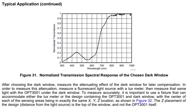

3. The OPT3004 spec has description “Normalized Transmission Spectral Response of the Chosen Dark Window”, What does this mean? Is it related to receiving infrared light?

    3, This is an application example and spectrum shown is of a dark glass cover and not our sensor. Dark glass will intensify IR relative to visible, but this is not a spec related to the OPT device itself.
