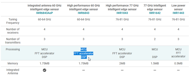

Is it possible to modify frameCfg by IWR6843 itself, without external MCU ?
Or, shall we use an external MCU to control IWR6843 by CLI command ?

    Ti's mmwave devices which have built in  post processing cores  are intended to program the RF Front end (Radar SubSystem ) via the available applications cores:
    For our demo examples  (Like OOB demo and others demo available as Labs in Industrial Toolbox )  we provide uart as an easy way for users to configure and modify the device  settings - eventually these setting are sent to the  Radar Subssytem via the available application cores on the device.  By doing changes to the code on the post processing application core a new configuration can be sent to the Radar Subsystem for a new Chirp setting.
    Please look at the Link layers in the SDK to  see how the  application/post processing cores interact with RadarSubsytem.
