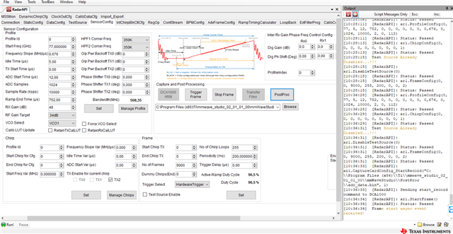

Hi Team,
We would like to ask your help regarding the customer's inquiry below.

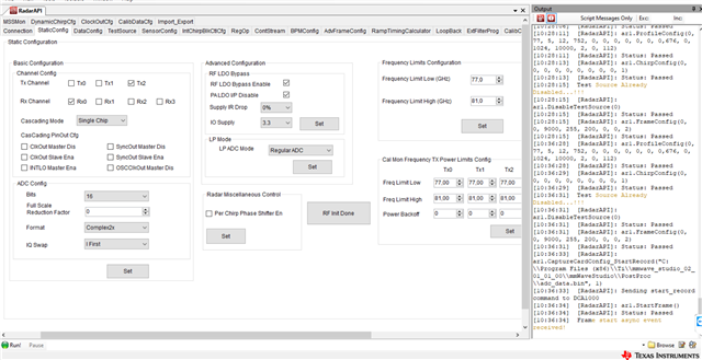

Our AWR1843boost does not measure the imaginary part as we expected. We use the radar with a DCA1000EVM and in several measurement we register an imaginary part very high as shown in the attached figure. Usually it is between -200 to 200 AU, but in some measurement it goes up to 8000. If the measurement is long (30 minutes) the imaginary part is always bigger than 8000. I attached also the radar configuration.

  • Hi Cesar,
    Thank you for your response. We have received this feedback from our customer.
    1. we bought the DCA1000 in 19-apr-2021. The lot. is 0806202001.
    2. the problem happened with the configuration with frame rate very slow (from 100 ms to 400 ms). We are trying to achieve 1 km of unambiguous range. The radar works (and we saw clear and correct targets up to 800/900 m) just for the first 1500/300 frames, after that the imaginary part is completely wrong as you can see in the screen shot.
    3. we used 1024/2048 samples.
    In general when we use the frame rate of 10/20 ms with unabigous range of 150/300 m the radar worked correctly.
    Danilo
    My feeling is that there is some data corruption. Since you are using a high number of samples, it is possible that some samples are dropped.
    Can you increase the packet delay in the dca1000 configuration to check is anything changes?
    thank you
