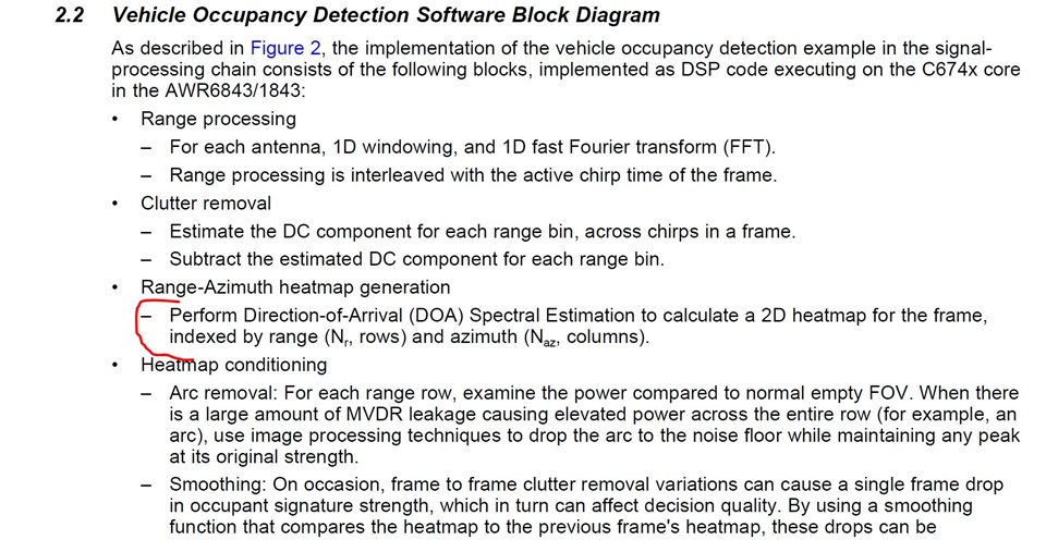

Q1. What's the row and columns number represent in Heatmap? Is it range bin and angle bin number and why?

    Yes, range-azimuth heatmaps are indexed by range and azimuth bin index. They are useful as they essentially contain all the information needed for a 2D representation of a scene.
