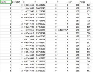

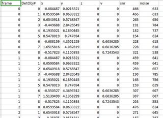

Hai Sudharshan,
I was able to convert .dat file to .csv. I had taken data using 68xx_mmwave_sdk_dsp and 68xx_mmwave_sdk_hwa OOB demos. Could you please what is difference in the output of two? I am attaching both the obtained output.
this is dsp output
this hwa output
And also the value of z is 0 for both output. Why is it like that?
Other than this is it possible to get vx,vy,vz,ax,ay,az.?

The OOB demo is provided as reference and may not have all the features needed. Also can you please use the config files located at ti\mmwave_sdk_03_05_00_04\packages\ti\demo\xwr68xx\mmw\profiles? and use the "profile_3d.cfg" and do the testing?
