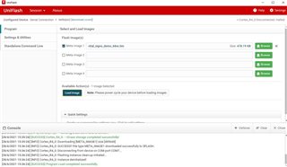

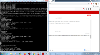

Our customer encounters hang up in using the vital signs demo, even though the flash has been loaded and completed successfully. What causes the problem?
The customer has changed the cable and also reconnect the board but it doesn't work.
QT version =  5.9.1
QMetaObject::connectSlotsByName: No matching signal for on_buttonBox_accepted()
Serial Port Found
Data Port Number is "COM5"
User Port Number is "COM5"
Data port succesfully Open
User port did not Open
Configuration File Name Read from the GUI is %s/n "xwr1642_profile_VitalSigns_20fps_Back.cfg"
Configuration File Path is %s/n "C:/ti/mmwave_industrial_toolbox_4_7_0/labs/vital_signs/68xx_vital_signs/gui/profiles/xwr1642_profile_VitalSigns_20fps_Front.cfg"

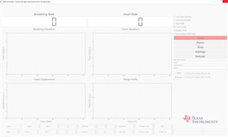

  • Hello Mr. thanks for your support and we are also facing the same issue. I am attaching the screenshot of the issue for you reference.
    We are able to the run the out of box demo for this device/board for your information.
    Lab:- 68xx_vital_signs.
    Hardware used:- IWR6843AOP EVM paired with MMWAVEICBOOST board.
    The above image is the screenshot of the issue which we have facing for the past 5 days. kindly do the needful and help us with the issue.

  • Hi Carlo
    It seems user has selected COM5 for both UART and DATA ports. Please make sure user has selected each port appropriately.
