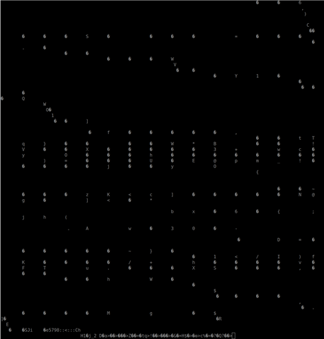

    5a. Using another screen session like [screen /dev/ttyUSB1 921600] I listen to the data port, and the answer looks like this:
    5b. Using my C program, I read in 2^16 Bytes into a buffer from /dev/ttyUSB1 and look for the magic word, which I can not find.
    5c. Using stty like [stty -F /dev/ttyUSB1 speed 921600 cs8 -cstopb -parenb] I configure another terminal to treat the serial device /dev/ttyUSB1 as an 8N1 UART device with baudrate of 921600. I then dump the contents into a file with [cat /dev/ttyUSB1 > uart.txt]. with [hexdump -C uart.txt | grep "01"] I look for the magic word, which I can not find.
    I am puzzled by the fact that the config port works like a charm, but the output of the data port seems nonsensical. What am I missing here?

    I changed the source code to only send out the message header. With a screen terminal like [screen /dev/ttyUSB1 921600] I get stuff like this:
    `�X�Ch
    B�G��X�Ch
    C*t¯X�Ch
    Dȇ�X�Ch
    E,�$�
         X�Ch
    F8�U�
         X�Ch
    G"���
         XCh
    H
    XCh
    I#��Ch�
    J����X�Ch
    K��K�X�Ch
    L��|�X�Ch
    Mj)��X�Ch
    N"�߼X�Ch
    O���X�Ch
    Pt�A�X�Ch
    Q$+s�X�Ch
    R�
    ��X��^C
