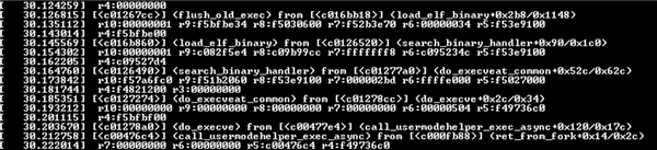

My group has purchased two separate MMWCAS-DSP-EVM boards (PROC055-011) along with the MMWCAS-RF-EVM (PROC054) frontend featuring the AWR2243P chips. I am following the guide mmwave_studio_cascade_user_guide.pdf in order to get it properly configured for first time use. I have flashed the TDA firmware using the instructions provided in section 4.2 of the guide. The image file I used was sdimage_3_7_1.img.xz. However, when trying to boot the EVM, one of the DSP boards results in the following output:
Failed to start Load Kernel Modules. Not Sure if that's consequential, but eventually the boot sequence gets stuck as shown in the figure below and I am unable to get to formatting the SSD per section 6 of the guide. I am of course unable to perform any data capture using mmWave studio and when pinging the device, it doesn't respond at all.
The second DSP board does not have any serial output. It doesn't seem to begin the boot process at all and none of the LEDs are illuminated on the MMWCAS-RF-EVM board when plugged into that DSP board.
My guess is reinstalling the kernel on the FPGA might help solve the issue, but I was unable to find instructions on how to do that. Any feedback would be much appreciated.
    Could you please check visually that the DSP board looks OK?
    Could you please send us the entire log?

  • Hi Cesar,
    Visually the boards look fine; they are always handled with great care. Here's the full log:

    [    8.857863] Unable to handle kernel paging request at virtual address 325ea025
    [    8.865127] pgd = c0003000
    [    8.867844] [325ea025] *pgd=80000080004003, *pmd=00000000
    [    8.873283] Internal error: Oops: 206 [#1] PREEMPT SMP ARM
    [    8.878790] Modules linked in: virtio_rpmsg_bus bc_example(O) extcon_usb_gpio pvrsrvkm(O) ahci_platform libahci_platform libahci c_can_platform libata c_can can_dev omap_aes_driver scsi_mod omap_sham dwc3_omap rtc_omap omap_rng extcon rng_core omap_des omap_remoteproc remoteproc virtio virtio_ring sch_fq_codel
    [    8.906579] CPU: 1 PID: 72 Comm: mmcqd/0 Tainted: G           O    4.4.84-00041-g84382ab #1
    [    8.914964] Hardware name: Generic DRA74X (Flattened Device Tree)
    [    8.921082] task: f5abda00 ti: f5418000 task.ti: f5418000
    [    8.926508] PC is at part_round_stats_single+0x44/0x74
    [    8.931667] LR is at 0x1
    [    8.934211] pc : [<c028d430>]    lr : [<00000001>]    psr: 00030193
    [    8.934211] sp : f5419dc4  ip : 00000001  fp : f5419dd4
    [    8.945738] r10: f63d4800  r9 : 00000000  r8 : 60030113
    [    8.950983] r7 : 00000000  r6 : ffff8e46  r5 : 00000001  r4 : 325ea000
    [    8.957537] r3 : 00000001  r2 : ffff8e46  r1 : f5a06c40  r0 : 325ea001
    [    8.964092] Flags: nzcv  IRQs off  FIQs on  Mode SVC_32  ISA ARM  Segment kernel
    [    8.971518] Control: 30c5387d  Table: b5a6a8c0  DAC: 55555555
    [    8.977286] Process mmcqd/0 (pid: 72, stack limit = 0xf5418210)
    [    8.983230] Stack: (0xf5419dc4 to 0xf541a000)
    [    8.987605] 9dc0:          f5b07400 f5419df4 f5419dd8 c028d6d8 c028d3f8 f5b07400 00000000
    [    8.995818] 9de0: 000002b4 00000000 f5419e14 f5419df8 c0290890 c028d69c f5400d98 00000000
    [    9.004031] 9e00: f59cf200 00000000 f5419e2c f5419e18 c0290a64 c0290764 f5400d98 00000000
    [    9.012244] 9e20: f5419e54 f5419e30 c0290b18 c02909e4 f5a06940 f5400d98 f5a06808 f5a06830
    [    9.020456] 9e40: 00000000 00000000 f5419e64 f5419e58 c0290b40 c0290ae8 f5419ecc f5419e68
    [    9.028669] 9e60: c04f5604 c0290b38 f5419e94 ffffe000 f63d486c 00000000 f5abda00 c0888cd0
    [    9.036881] 9e80: 00000000 00000000 00000000 f5a06800 00000000 00000000 f5a06800 00000000
    [    9.045093] 9ea0: ffffe000 f5a06808 f63d4800 f5b726dc f5b72400 f5a06800 ffffe000 00000000
    [    9.053306] 9ec0: f5419f24 f5419ed0 c04f5b18 c04f4e18 f59cf200 f5a06810 ffffe000 00000000
    [    9.061518] 9ee0: f5419f0c f5419ef0 c0291564 c02ad038 f5b72400 00000000 f59cf200 f5a06808
    [    9.069732] 9f00: 00000000 f59cf200 f5418000 f5a06810 ffffe000 f5400d98 f5419f54 f5419f28
    [    9.077943] 9f20: c04f74b8 c04f58c4 f5abda00 00000000 f5a6a4c0 f5418000 f5a06808 c04f73b4
    [    9.086156] 9f40: 00000000 00000000 f5419fac f5419f58 c0050508 c04f73c0 00000000 00000000
    [    9.094368] 9f60: 00000000 f5a06808 00000000 00000000 f5419f70 f5419f70 00000000 00000000
    [    9.102580] 9f80: f5419f80 f5419f80 f5419fac f5a6a4c0 c0050408 00000000 00000000 00000000
    [    9.110793] 9fa0: 00000000 f5419fb0 c000fb88 c0050414 00000000 00000000 00000000 00000000
    [    9.119005] 9fc0: 00000000 00000000 00000000 00000000 00000000 00000000 00000000 00000000
    [    9.127216] 9fe0: 00000000 00000000 00000000 00000000 00000013 00000000 ffffffff 00000001
    [    9.135425] Backtrace:
    [    9.137893] [<c028d3ec>] (part_round_stats_single) from [<c028d6d8>] (part_round_stats+0x48/0x5c)
    [    9.146801]  r4:f5b07400
    [    9.149355] [<c028d690>] (part_round_stats) from [<c0290890>] (blk_account_io_done+0x138/0x280)
    [    9.158088]  r7:00000000 r6:000002b4 r5:00000000 r4:f5b07400
    [    9.163809] [<c0290758>] (blk_account_io_done) from [<c0290a64>] (blk_finish_request+0x8c/0x104)
    [    9.172629]  r7:00000000 r6:f59cf200 r5:00000000 r4:f5400d98
    [    9.178349] [<c02909d8>] (blk_finish_request) from [<c0290b18>] (blk_end_bidi_request+0x3c/0x50)
    [    9.187168]  r5:00000000 r4:f5400d98
    [    9.190777] [<c0290adc>] (blk_end_bidi_request) from [<c0290b40>] (blk_end_request+0x14/0x18)
    [    9.199335]  r9:00000000 r8:00000000 r7:f5a06830 r6:f5a06808 r5:f5400d98 r4:f5a06940
    [    9.207160] [<c0290b2c>] (blk_end_request) from [<c04f5604>] (mmc_blk_issue_rw_rq+0x7f8/0xaac)
    [    9.215813] [<c04f4e0c>] (mmc_blk_issue_rw_rq) from [<c04f5b18>] (mmc_blk_issue_rq+0x260/0x4f4)
    [    9.224546]  r10:00000000 r9:ffffe000 r8:f5a06800 r7:f5b72400 r6:f5b726dc r5:f63d4800
    [    9.232449]  r4:f5a06808
    [    9.235004] [<c04f58b8>] (mmc_blk_issue_rq) from [<c04f74b8>] (mmc_queue_thread+0x104/0x178)
    [    9.243476]  r10:f5400d98 r9:ffffe000 r8:f5a06810 r7:f5418000 r6:f59cf200 r5:00000000
    [    9.251378]  r4:f5a06808
    [    9.253935] [<c04f73b4>] (mmc_queue_thread) from [<c0050508>] (kthread+0x100/0x118)
    [    9.261620]  r10:00000000 r9:00000000 r8:c04f73b4 r7:f5a06808 r6:f5418000 r5:f5a6a4c0
    [    9.269522]  r4:00000000 r3:f5abda00
    [    9.273133] [<c0050408>] (kthread) from [<c000fb88>] (ret_from_fork+0x14/0x2c)
    [    9.280382]  r8:00000000 r7:00000000 r6:00000000 r5:c0050408 r4:f5a6a4c0
    [    9.287152] Code: e0423003 e7944100 e1a0000c e0800004 (e590c024)
    [    9.293274] ---[ end trace f6e7e70ccaf9a379 ]---
    [    9.297910] note: mmcqd/0[72] exited with preempt_count 2
    [   29.876881] INFO: rcu_preempt detected stalls on CPUs/tasks:
    [   29.882583] 	0-...: (1 GPs behind) idle=12b/140000000000000/0 softirq=3300/3336 fqs=27
    [   29.890621] 	(detected by 1, t=2102 jiffies, g=186, c=185, q=14375)
    [   29.896923] Task dump for CPU 0:
    [   29.900163] systemd-udevd   R running      0   706    191 0x00000002
    [   29.906560] Backtrace:
    [   29.909027] [<f7722d5c>] (0xf7722d5c) from [<00000001>] (0x1)
    [   29.914795] Backtrace aborted due to bad frame pointer <00000001>
    [   29.920916] rcu_preempt kthread starved for 2032 jiffies! g186 c185 f0x0 s3 ->state=0x0

    I have discussed this with the team.
    The logs that you have provided seems to indicate that the information on the SD card is corrupted.
    Can you please try another SD Card?
    Thank you
    Cesar
    I have tried 5 different SD cards, including the two provided by TI and none of them seemed to work. Is there anything else I can try or should we return the boards?

    Sorry for the delay
    Yes, please contact customer service to return the boards. Please refer to this e-mail thread.
    Thank you
