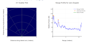

    I'm trying to understand your problem. The data is accessed from the UART stream. There is a format to how the data is output. You can find a description of that at the bottom of the People Counting User's Guide.
    For plotting purposes, do you need to create your own GUI? We have developed a python GUI included in the Industrial Toolbox. Instructions on how to use the GUI are included in the People Counting User's Guide. You could edit this python source to print out the information you are looking for. Essentially, doing this you no longer have to parse the UART stream, it's already done for you.
    I'm not sure what you mean by "I would also like to know how i could determine the target's range based on the point cloud's range". The range for each point and target can be calculated by finding the magnitude of the x, y, and z positions.

    I used the exe file of the GUI for the 3D people counting demo and it worked very well.
    But when I tried to modify the source code and run the gui_main.py program I had errors due to fbs_runtime.

    Yet I tried the demo with the mmwave demo viisualizer 3.5 version and I do have all the plots
    I also read the .dat after recording the test using mmwave visualizer with  the mmw_demo_example_script.py and parser_mmw_demo.py files from C:\ti\mmwave_sdk_03_05_00_04\packages\ti\demo\Parser_scripts
    and got this:  (I USED THE SAME CONFIG FILE for both the mmwave visualizer and the oob_parser )
