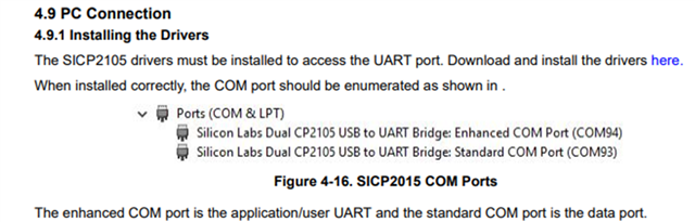

    Please refer to the below snippet from the following user guide: 60GHz mmWave Sensor EVMs (Rev. D) (ti.com)
    Referring to the attached figure above, Rev C and Rev D version of XWR6843 boards (ISK/ODS) have CP2105 USB to UART chips present, hence one need to use the following drivers instead of XDS110 :
    https://www.silabs.com/products/development-tools/software/usb-to-uart-bridge-vcp-drivers
    Ishita

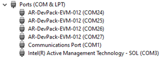

    Thank you for your advice regarding real-time data capture. I will explore the methods you recommended.
    Below are the available COM ports when connecting the device via the RADAR_FTDI port as the Quick Start Guide advises:
    Only when connecting to the micro USB port on the AWR6843 itself (used for the mmWave Demo Visualizer), I get the COM ports you referred to:
    After taking steps to ensure none of the ports were in use by other processes and trying each port individually, none of the 6 COM ports connect to mmWave Studio.

  • Hello Mitchel,
    You need to use COM 30 in this case to connect with RS232 for mmwave studio connection.
    Are you using the AWR6843ISK device in standalone mode or with mmWaveICEboost? I am not able to understand your physical setup and connections.
