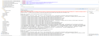

I'm trying to hardcode the cfg for area scanner on IWR6843AOP and for long range on IWR6843ISK. There is a hardcode bin file only on Out of box demo and it works only on ISK and not on AOP because of the different antenna pattern please correct me if I'm wrong.
In CCS/IWR1443: there are some question in MmwDemo_CLISensorStop(1,initcfg_stop).why? - Sensors forum - Sensors - TI E2E support forums there is a zip file attached with some example code for using a hard-coded sensor configuration with IWR1443 and mmWave SDK 1.2 but I want to make changes on IWR6843AOP and IWR6843ISK as mentioned earlier. The updates are made to the cli.c file that is part of the cli library in the mmWave SDK. So the question here is if the same file can be used for IWR6843ISK and IWR6843AOP and done in the same way?

    I backed up the cli file from the mmwave_sdk_01_02_00_05\packages\ti\utils\cli\src directory and replaced the new cli.c file in the directory and now I locally built it. The new cli.c file is attached. /cfs-file/__key/communityserver-discussions-components-files/1023/2185.cli.c
    But I have a compilation error and I see it is something to do with with linker stage or binary file error. How can I fix it?
