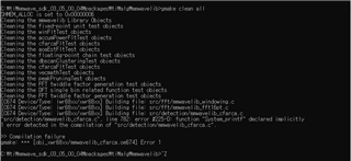

  • Thanks for your support .
    I have tried your advice.
    but  it couldn't compile
    below message is the result to try
    "function "system_printf" decllared iplicitly
    I want to see the value of variable in "mmwavelib_cfarca" file
    what command can I use?

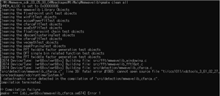

  • How about try add  #include <xdc/runtime/System.h>  in cfarca.c?
  • Thanks for your answer
    I have add #include <xdc/runtime/System.h>  in cfarca.c
    but the result is the same. please refere below

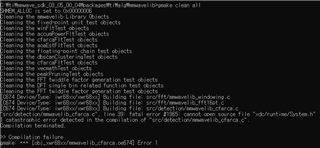

    and I have changed the directroy from <xdc/runtime/System.h> to <ti/ccs1011/xdctools_3_61_02_27_core/packages/xdc/runtime/System.h>
    Because My case system.h file is in this directory
    but result is the same
    and I have one more question
    Can I use  System_printf() in the "mmwabelib_cfarca.c" file ?
    Is there any function for using "mmwabelib_cfarca.c" file ?
    An alternative approach to using System_Printf() would be to use CCS Debug to check any values of interest during the execution of the code. Below is a resource that describes what needs to be done to change the optimization in the building process of the SDK libraries.
    SDK Deep Dive - Debug Guide: Time stamp: 56:10
    training.ti.com/easy-evaluation-and-development-mmwave-systems-software-development-kit
