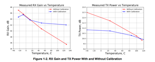

It is found to have a certain relationship with temperature. In the Application Report Self-Calibration in Ti's mmWave Radar Devices document Figure1-2, the runtime calibration function is described. The chip will self-adjust the TX\RX Gain value as the temperature changes. If we put this The gain is fixed to compensate a relatively high value. What impact will this have on subsequent mass production?

  • Hello Users,
    Apologies for the delay on this, had to get some information for this from the internal team. Please find my response below :
    1. Yes, that is correct. As you can see from the graph illustrated below, the performance varies at different temperatures and degrades at high temperatures.
    3. As I mentioned in my previous response, the RF parameters of the device may vary from device to device due to manufacturing process variations and also across temperature. Calibrations help to ensure those values remain AS PROGARMMED BY THE USER across all temperatures and process variations. If calibrations are not enabled, RF parameter say TX Power will degrade a lot at higher temperatures.
    Now coming to the types of calibrations, we have periodic calibrations enabled within the device, so it basically runs the calibrations routines at a periodic rate (as entered by the user) and based on the temperature of the device at that point in time, calibrates the value. There is an LUT for this purpose and it has multiple values. When you set a particular gain setting in the profile config, the firmware computes the Rx gain LUT values (there are 18 value for -40C to 140C) temperature range (and similarly for TX).
    This is the disadvantage of keeping a fixed value throughout. If the device works across temperature, the calibration value/LUT value will also vary across temperature, and hence the user/host need to take that into consideration while programming a fixed value. You can run the one-time calibrations instantly any number of times by issuing AWR_RUN_TIME_CALIBRATION_CONF_AND_ TRIGGER_SB API. For example, you can keep a temperature range as a deciding factor and if the device at any point in time changes the range, you can issue the run time API with one time calibrations enabled to account for that temperature change.
